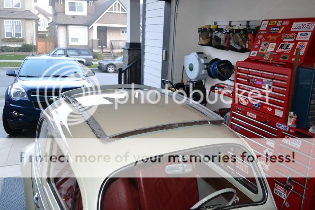

Well here I go ..... starting to installing a rag top section in my 58 Beetle with minimal body and paint work. I'm posting this so that can I ask for advice along the way and maybe help others learn from my mistakes. I cut the rag section out of the roof clip with about 1"all the way around except of the rear part where I left more to help with the hole placements later. I started to trim away the top layer from the bottom layer as seen in the picture. This will give me something to weld against. I'm trimming it close enough so my seams will be hidden by the trim. I will post as I go along with this project.

« Reply #2 on: January 26, 2014, 05:34:37 PM »

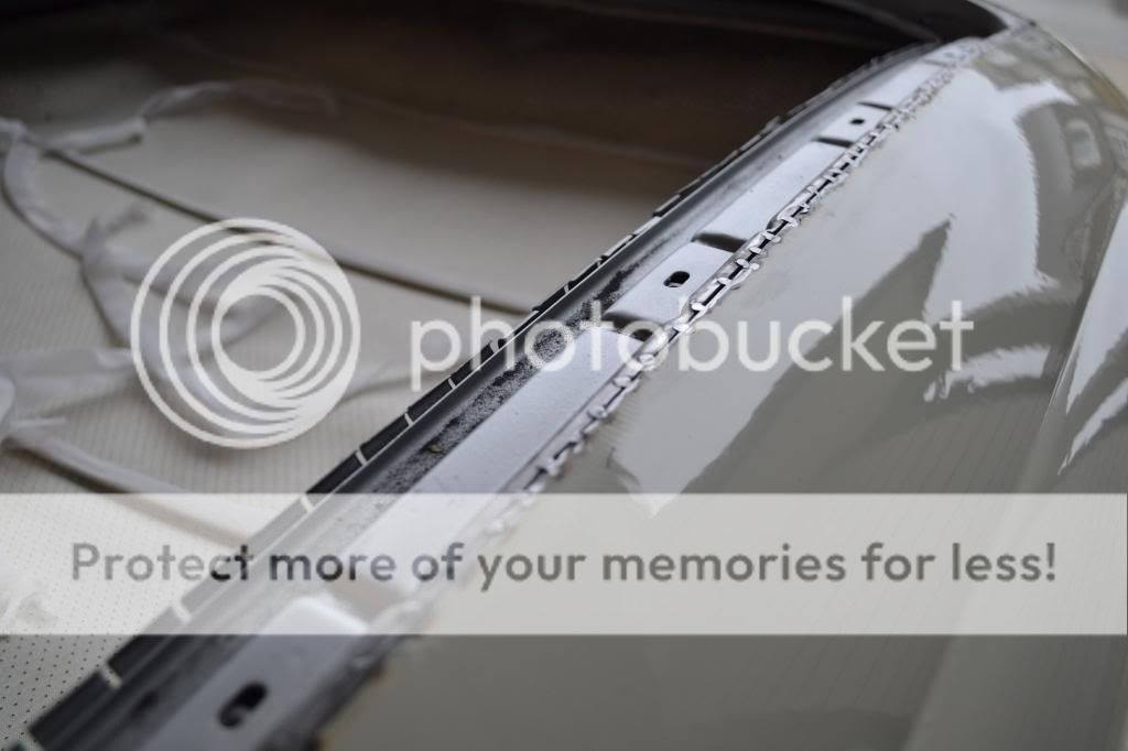

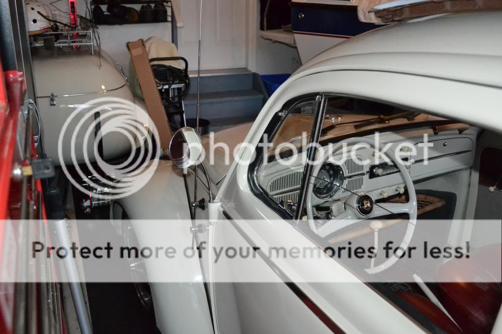

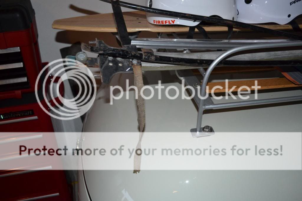

Well got some work done on the sunroof this weekend. I got side tracked installing a sapphire I radio and antenna on the car. I figured drilling holes for the antenna would help prep me for cutting the big hole in the roof.
Got the clip all trimmed out  and ready to start working out location.
Looking for the nylon like strapping material in this picture. Does anyone know where I can pick some up?

I just finished the 3 fold in my oval. The nylon you are asking about you can by from a fabric store...same shit as backpack straps. Although it was suggested to me to use 4" wide strips of the same material that the top is made of (called sonnetland?) A very tough fabric stayfast type with a rubber inside. Doesn't matter what it is really it just keeps the spacing between the rails even when operating roof. I'd use 1" backpack strap if I were you.

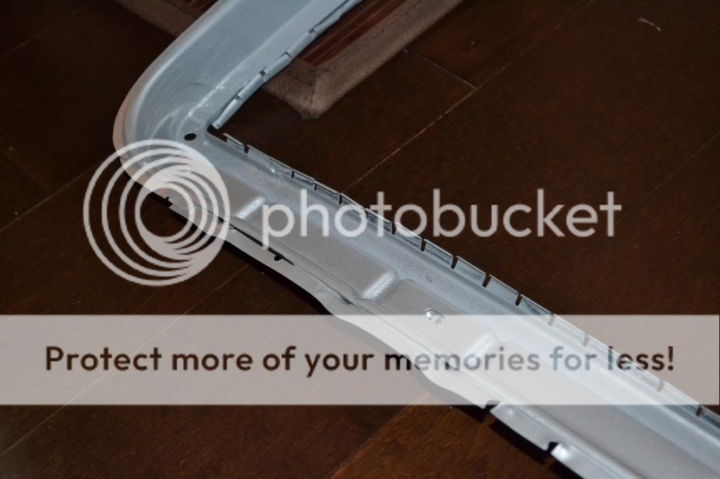

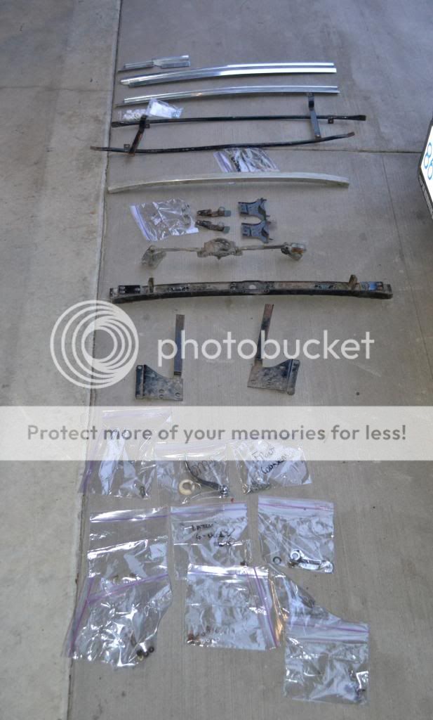

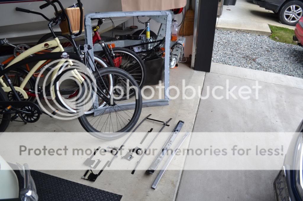

I got all the assembly apart and ready for sand blasting. I managed to get it apart with only 2 broken fasteners. Even though I took pictures I was wondering if some one could direct me towards some good ligature on the assembly of the sunroof to help in the reassembly part of the job. Thanks Tom

Thanks Silas, that will help. I notice that I'm missing piece 49. I'm assuming it goes on the underside of the roof when bolting down the back of the top. If anyone has one kicking around let me know or worst case I'm sure I can make something.
I have to give a shout out to Langley U blast as I was down there yesterday cleaning up all the parts. Their booth are big enough to even hold the roof clip. Nice people to deal with and the shop is kickass. They are going to expand soon and will have faculties to blast large objects. I got all the parts cleaned any painted yesterday. Hoping to have all in pieces in place so I can cut the hole in the roof by the Long weekend. I'm starting to dream at night about cutting that hole in the roof (or should I be saying night terrors).

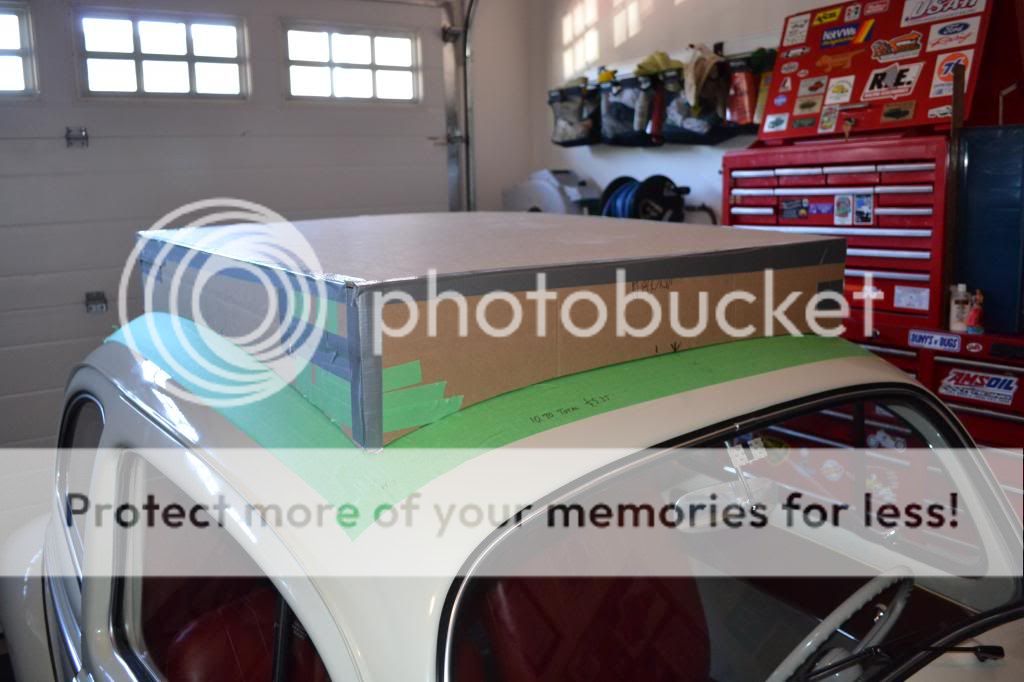

« Reply #12 on: February 08, 2014, 10:54:04 AM »
Well tomorrow is the big day chainsaw. After a few days of trying to figure out how to transfer the information from the clip to the roof I had an idea at work last night. I work in a box plant and I thought if I built a box the same size as the out line of the inner hole I could transfer it over (some times you just got to think outside the box). It seem to work out good...well we will see tomorrow.

Nice box!  no big deal! jump in and don't look back. good call ditching th fam, smart move
ive never pulled off either but difference in doing the 2-3 fold graft is where u splice it. A 3 you peel off all the roof skin and plug weld the frame opening clamping from underside....The 2 don't you have to use some of the donor roof skin and butt weld the whole perimiter?  am i on track or way off? like I said, never done a ragtop graft.
If that is the case I'd trim donor back close so it sits flush square up and use a bunch of self tapper sheet metal screws zapped through both layers pulling down tight then take the thinnest zip wheel you can get cut through (some guys split the screws) be careful not to let disk lean or trail off making the slice wider than need be=less weld.  Some guys use one of those little air recip saws cause the blade is nice and thin and you have good control.....think I saw one of china's finest quality tools at princess auto for under $20 that might last long enough to make it 3/4 the way around your roof before the bearings implode :character0029:

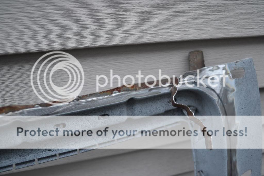

With the 2 folds u do have to use the donor skin partially.  The opening is stamped as u can see in the pic.  I have a 2 fold graft in the works and am watching Thomas closely.  I am thinking of using structural adhesive to glue it to the underside of the oe skin. It will sit about 1mm lower than what it should.... But I think I can get away with that over warping the hell out of the skin from welding and then grinding welds and filling. I have a lot of experience with the structural glues at the bodshop I work at and think I can save a bunch of work possibly.... Anyone have any good reason why glueing to the underside will not work?

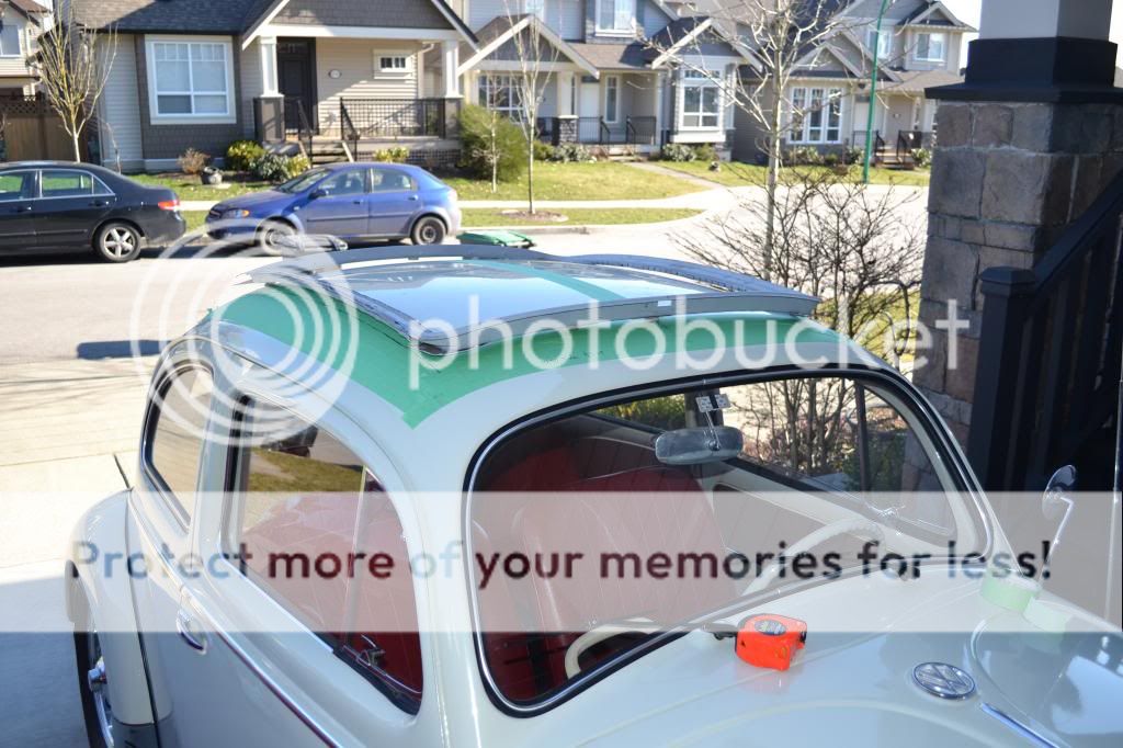

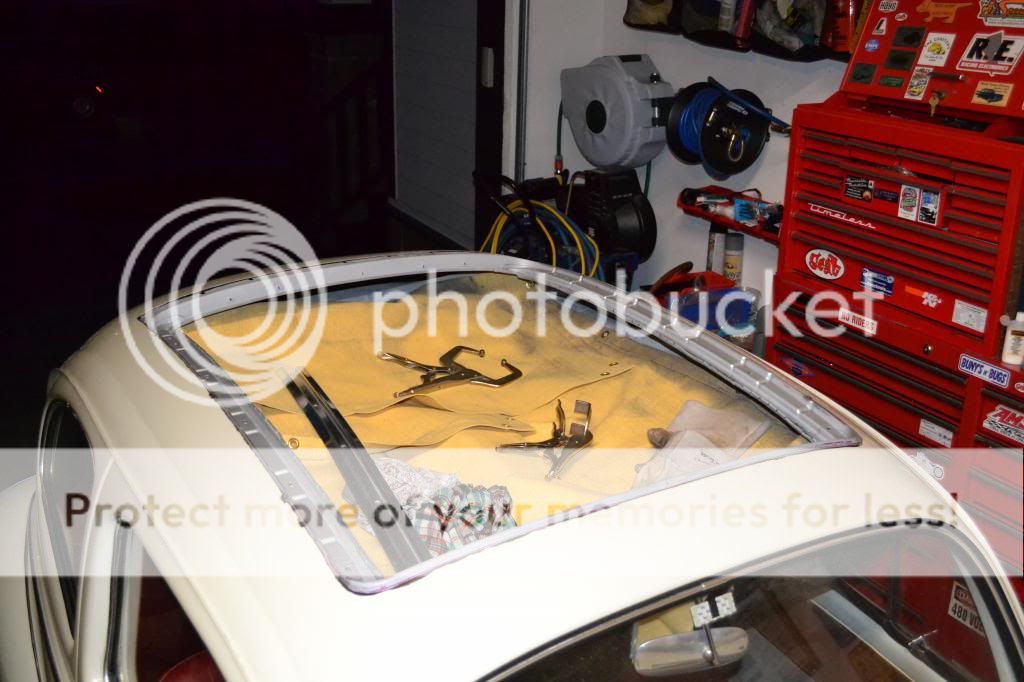

Here are some pictures from today.
Zinc spray weld paint as going to seam weld but will have the under skin to weld against.
Hole cut with jig saw. Left about 1/4" then I used a blending disk to finish it up and yes the full interior is still in.
Turned out to be close with only couple spots that have a little gap.
Looks like the trim should cover up the side welds.
next step will be welding one stitch at a time.

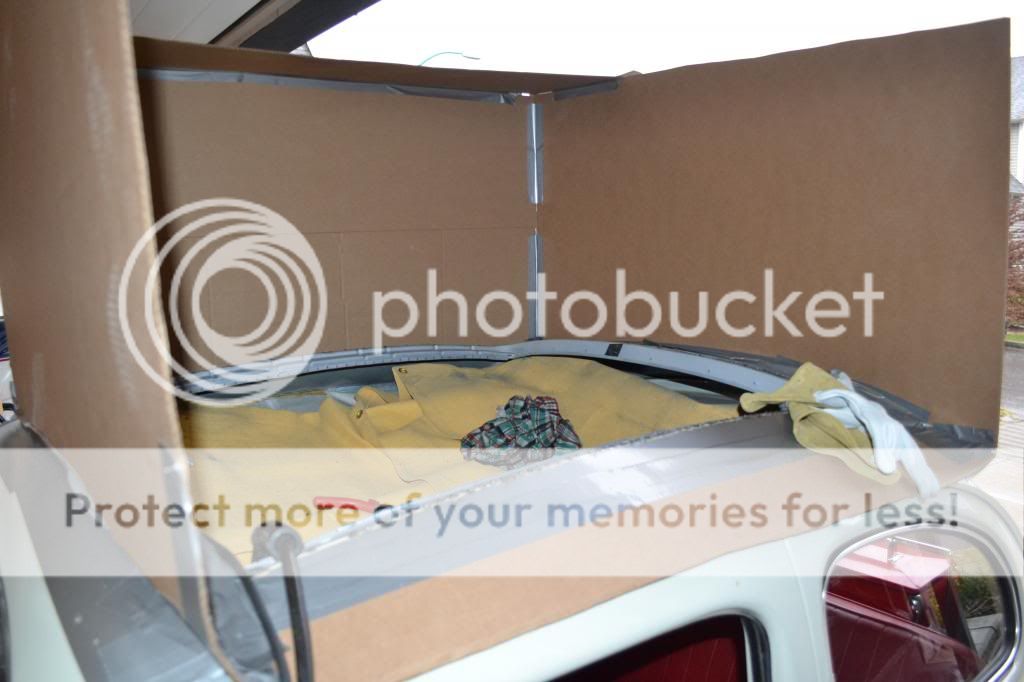

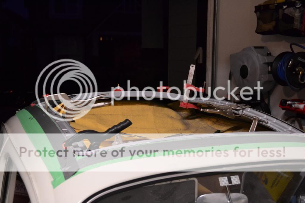

Well spent a couple hours welding today. The wind was blowing away my gas so I had to build a shelter... don't know if using a flammable material was to smart but it worked.
Stitch welding takes patience and it was testing mine. A few more to go to fill it all in.
So far except for one spot I have manage it keep it so I will be able to cover the sides.
Hoping to do more tomorrow.
