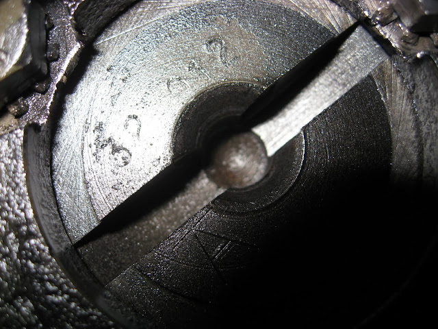

Just pulled the oil pump off and the stampings are reallly light. but I think they are " 32 012 " with an " A " on the lower half

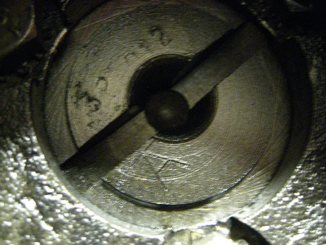

« Reply #6 on: November 08, 2010, 08:12:43 PM »
Some pics of the camshaft. Any ideas what it is?

« Reply #7 on: November 17, 2010, 09:45:33 PM »
Does anyone have ANY ideas what cam is in here??? I am really clueless on this one....

« Reply #13 on: January 19, 2011, 06:46:53 PM »
It's probably a vintage Treuhaft 32-012 camshaft which was similar to the Engle W-110. Have you measured it yet?

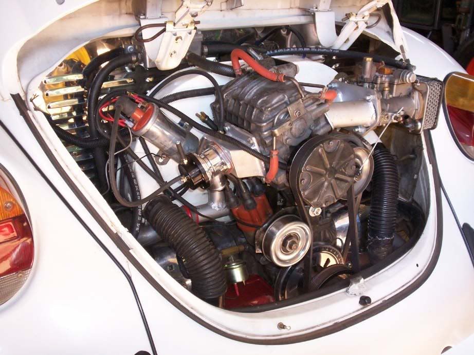

« Reply #19 on: February 27, 2011, 07:18:04 PM »
Picked up a supercharger..... Now I'm in trouble! lol_hitting
Was considering turbo, but this will be much more suitable for a driver. Just have to figure out how to mount it. Was thinking of Holly 4 barrel
The intake is on the end and the exhaust on the bottom. Some guy bought it for a snowmobile, but it wouldn't run. Considering it should have enough blow for a 4 litre I can understand why!
Anyone seen a blown Type1 before? Had one? Driven one?

« Reply #20 on: February 27, 2011, 07:40:14 PM »
Blown vw's go back to the 60's..... You can buy a few complete kits for them. The most popular lately was the DLI. Dick Landy that used a B&M blower. Lot's of info out there on them.
Before you bolt more power onto that engine I'd still recomend at least having that crank checked.
