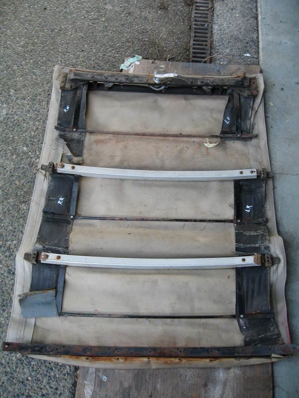

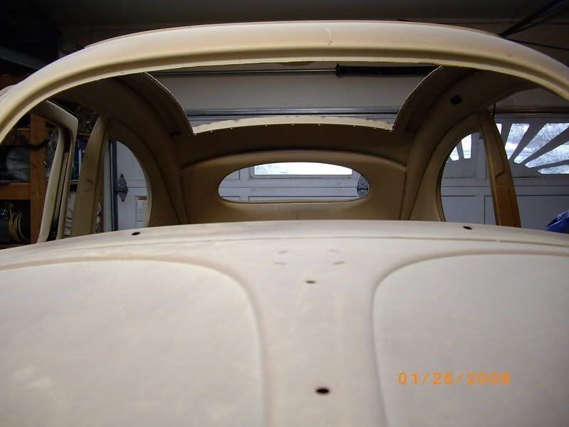

I tore down the rag and man some of those little screws are a biatch to get out after 53 years. some stripped, some snapped and ended up heating some up with the torch. will replace with all stainless hardware.

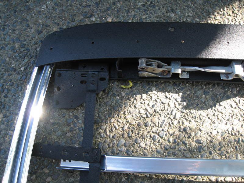

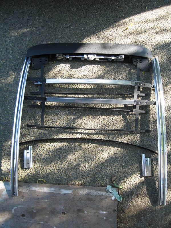

The original 3 fold....
and the mechanism parts after being stripped and powdercoated. Crincle black and the 2 aluminum bars done in chrome powder, side rails re-polished.
Almost too nice to cover in canvas.

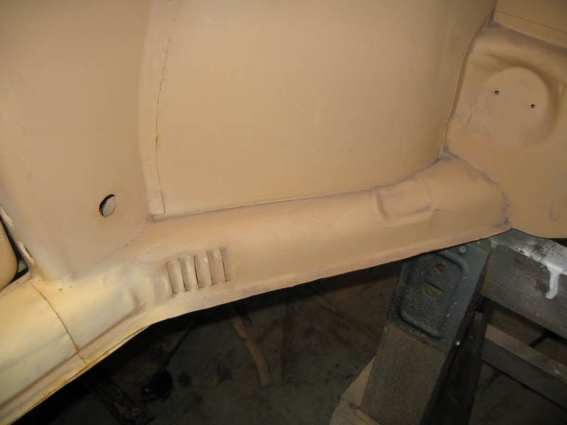

As far the body goes there are a couple areas that need some attention.

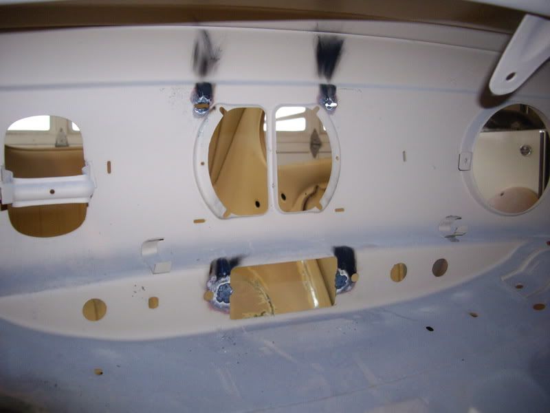

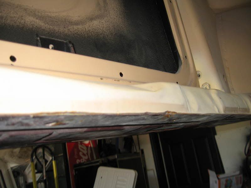

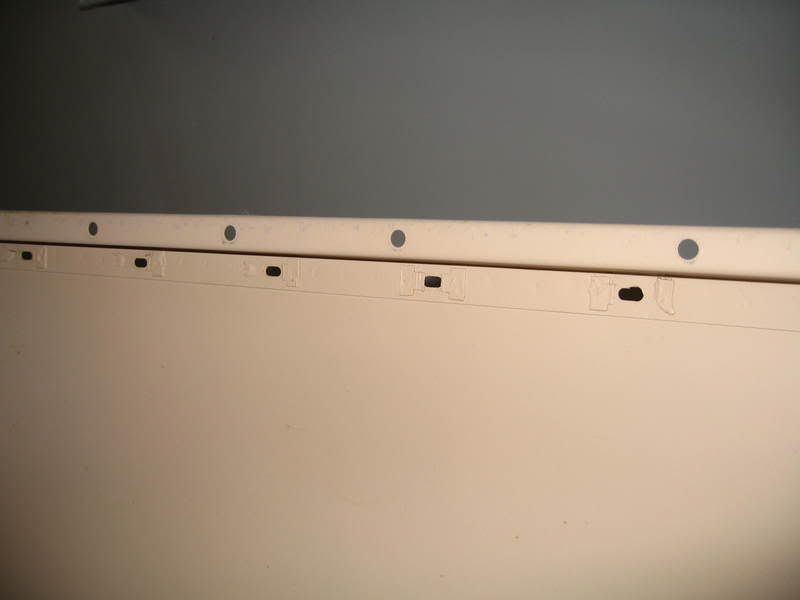

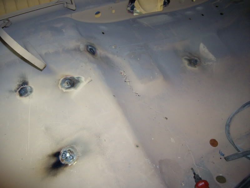

For some very strange reason the caged square nuts were cut off on the inside of the roof where the tensioning strip holds down the canvas.
I've started building new \"cages\" out of sheet metal and finnished drilling,tapping and cutting little square nuts out of 3/8\" flatbar, lotsa fun i'll tell ya :rolleyes: then i'll weld them all back on so I can adjust the canvas without having to pull the headliner to get a wrench on the inside.
I don't like the shape of the aftermarket heater channels at the front, they're all square like a 70's beetle and have the pressed louvered heat out lets instead of the mesh ones.
I found a set of original grills but once I got them shipped to me they turned out to be too rusty to use, oh well at least I have the shape/size to make new ones.
when I cut these areas out, i'll have a chance to coat the inside in rust bullet or something to protect them.

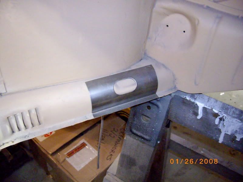

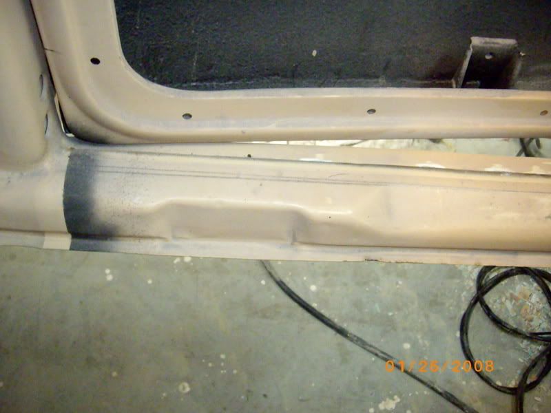

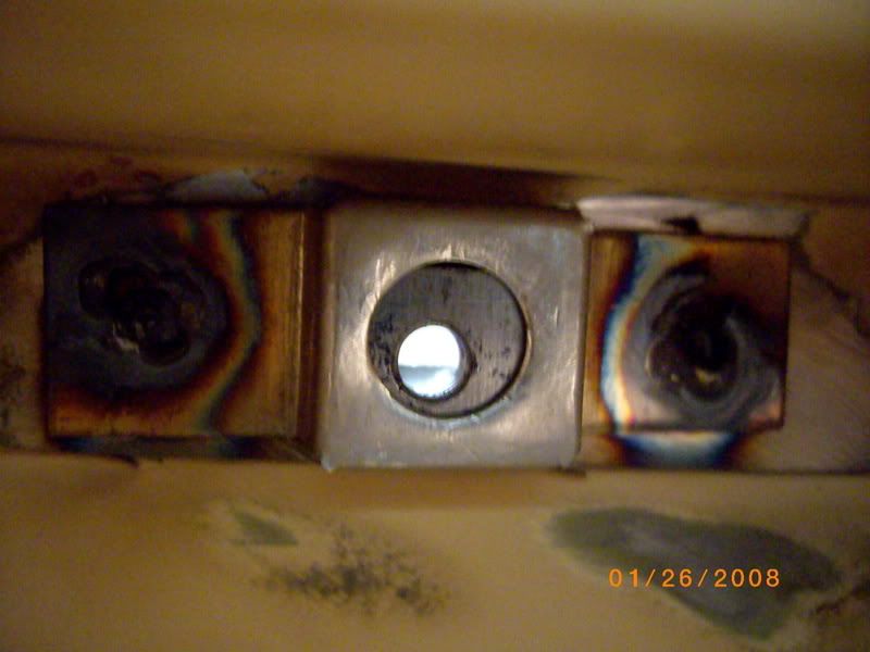

got the captive/caged nuts made up and welded back into the inside of the roof for the ragtop tentioning strip.

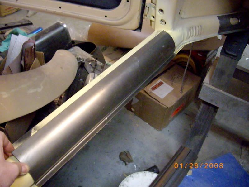

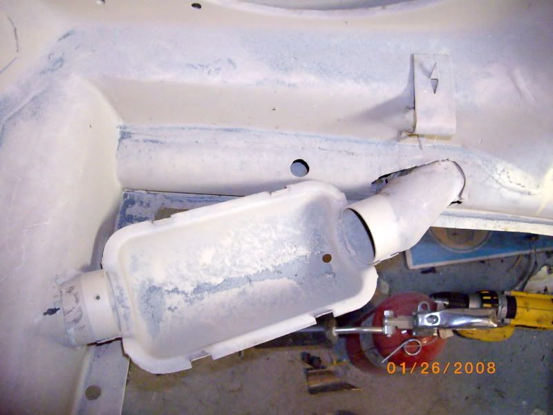

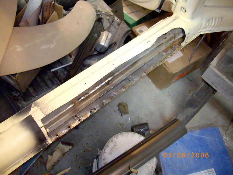

started on the heater channel recreation

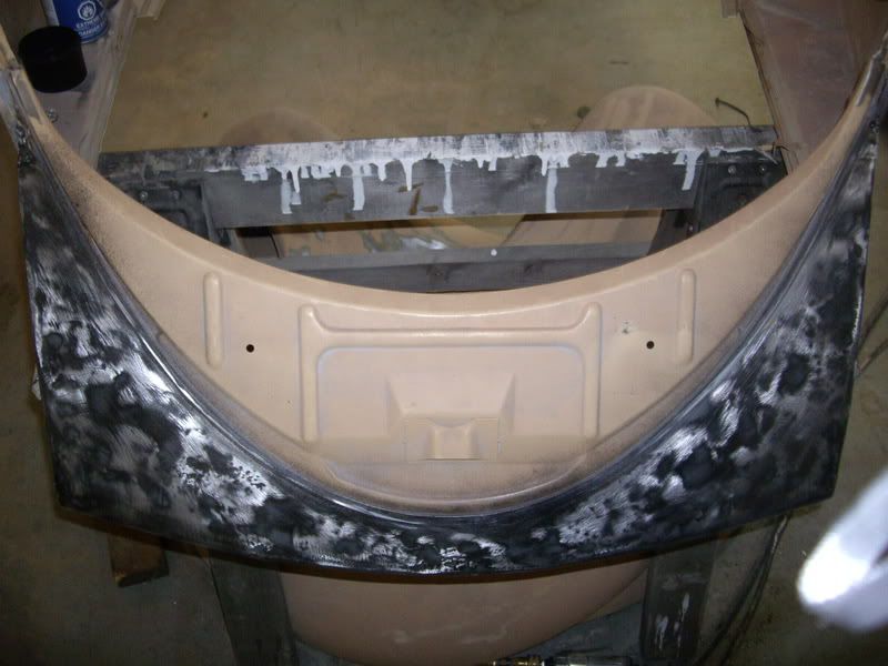

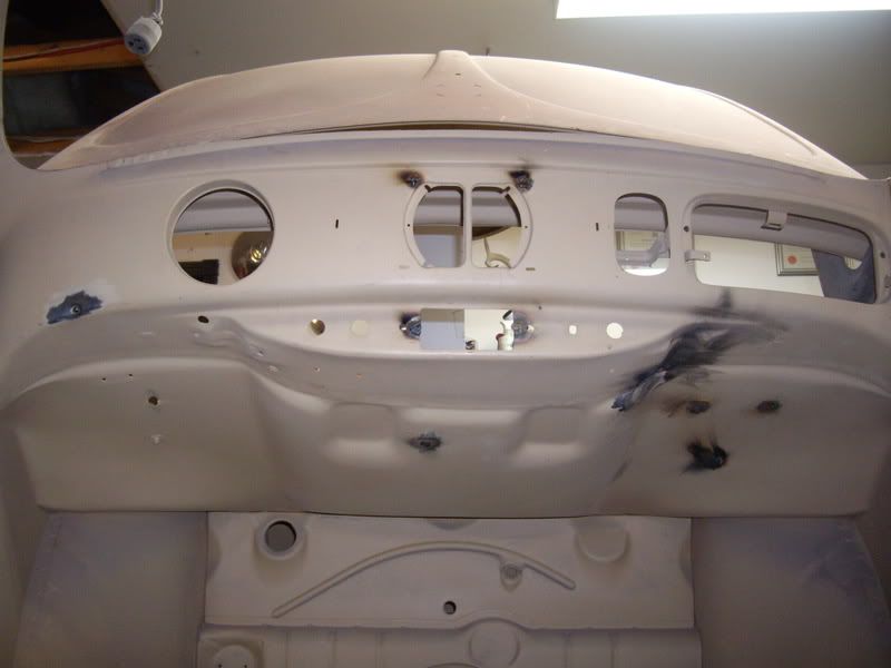

I don't like the heater tube outlets and where they go through the rear crossmember is crap so I think i'm gonna completely do away with them and weld the hole up..........who the hell runs heater boxes in a hot rod anyway :D  This will give me room to mount the accusump under the rear seat and some extra space by the torsion housing for my oil cooler.

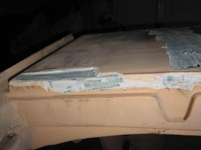

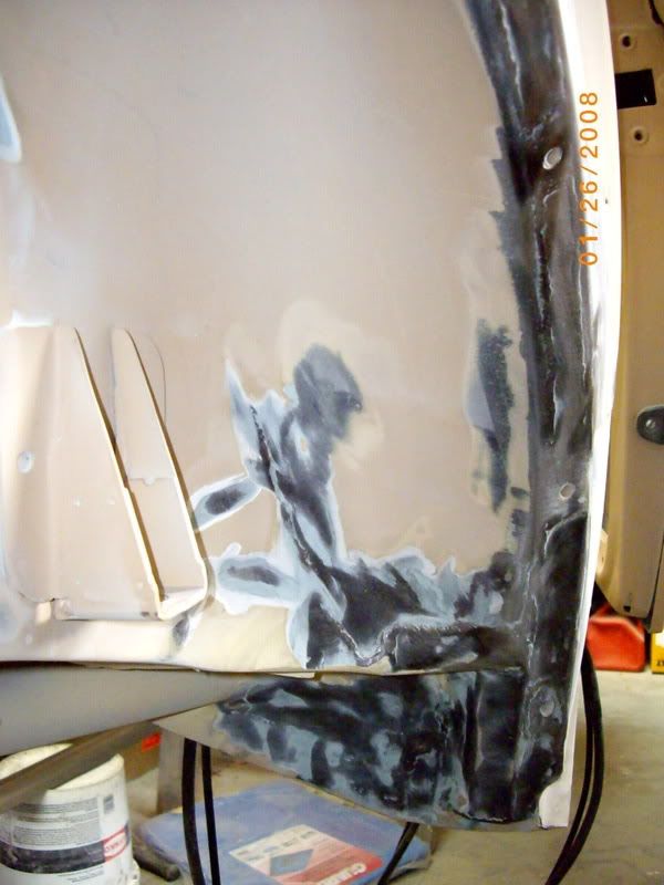

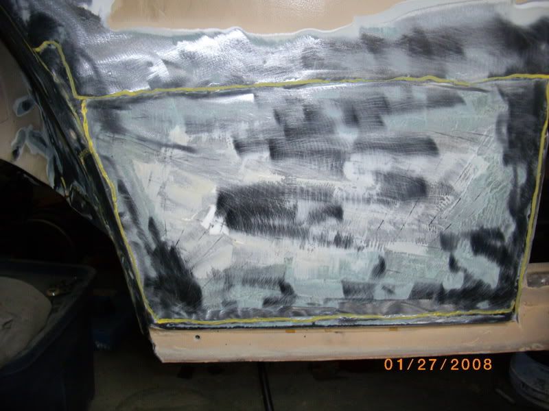

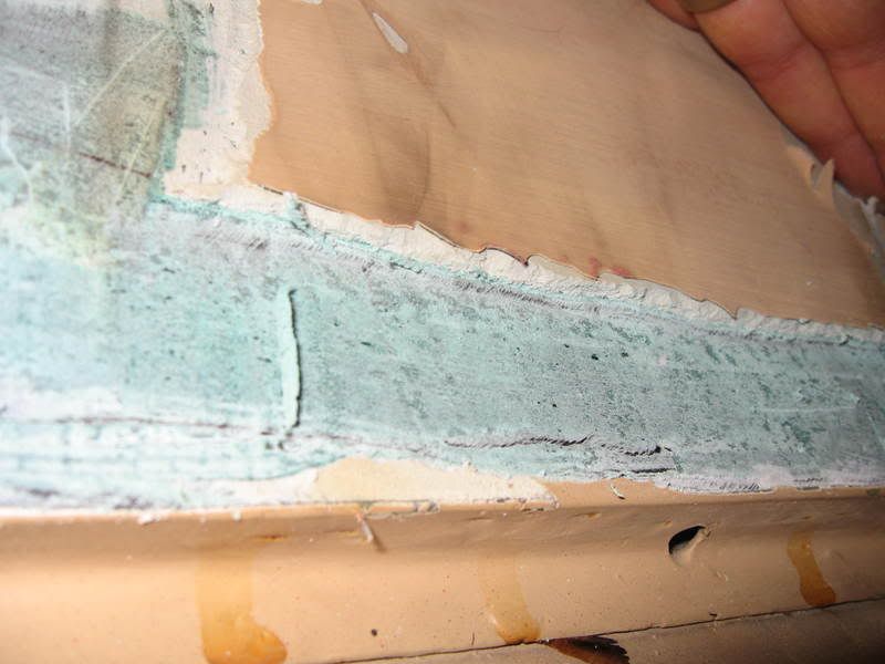

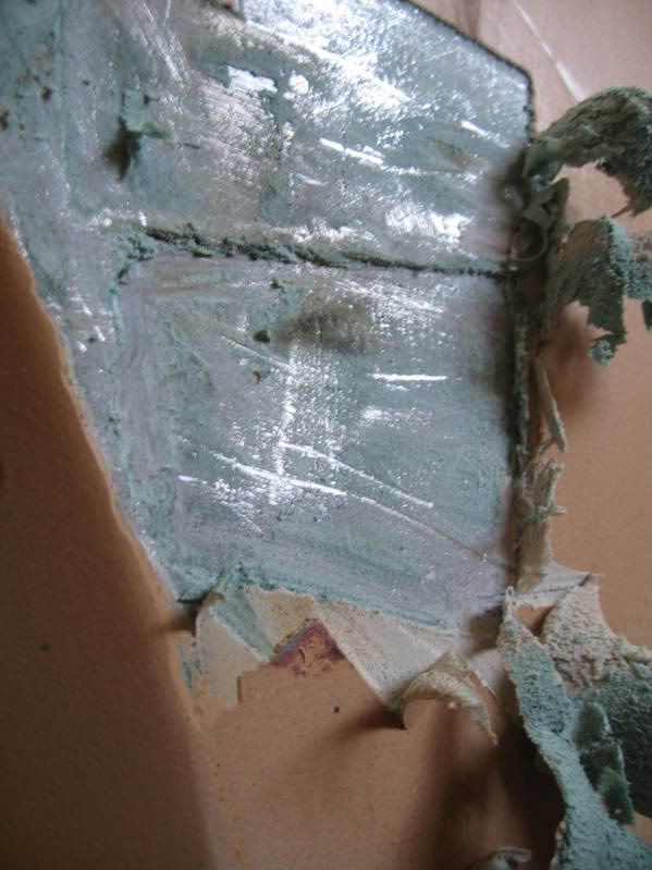

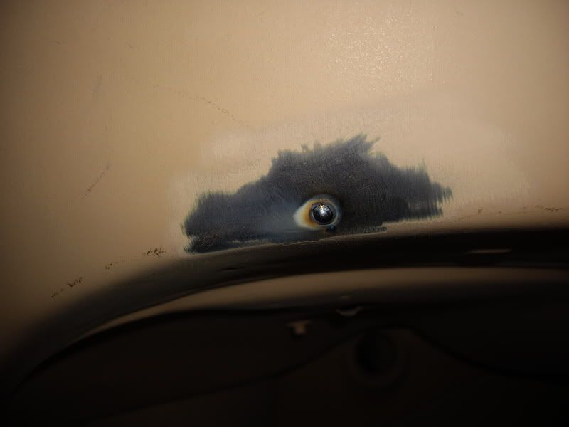

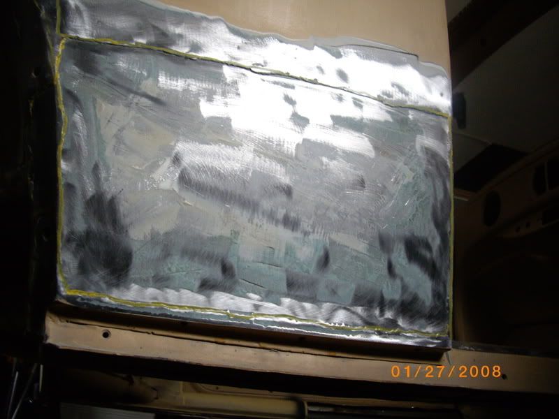

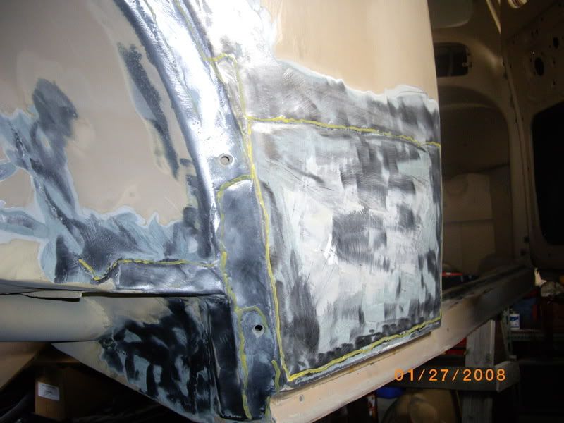

found some beautiful lap welds on the rear quarters they scabed back together :rolleyes:
this is the inside........
and outside skin, looked really straight, the guy was a sculpter :ph34r:
OK enough bondo pics.......

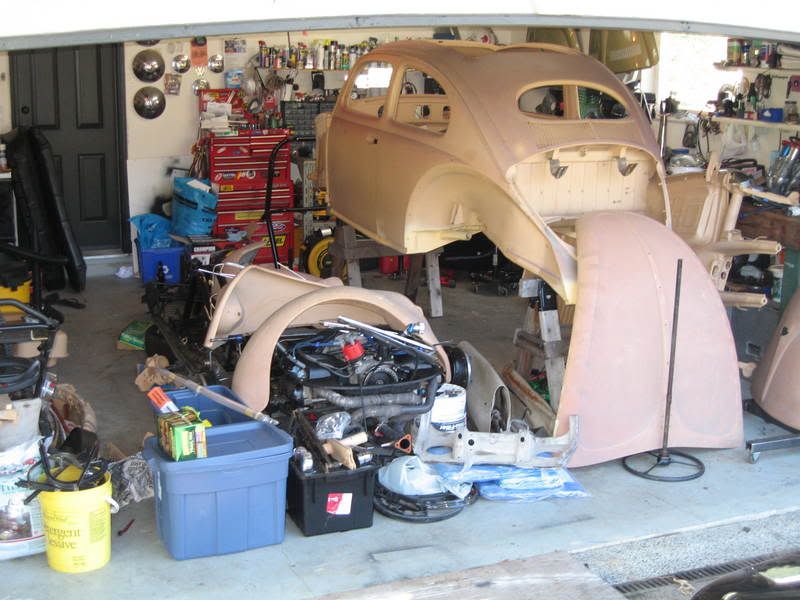

got the new pan head ready to go, just gotta build a jig to keep it true when welding. I calculated some built in caster to eliminate the need for shims under the beam.
I'm working getting on an entire ass end of an oval from cali, that's straight original geman and un fuct with to re-fix the past repairs and make it mint. I plan on building a rotissery for it and cutting out all the shady shit, send it to get walnut blasted and then i'll have a clean slate to start welding to.
a couple parting shots just cause.....

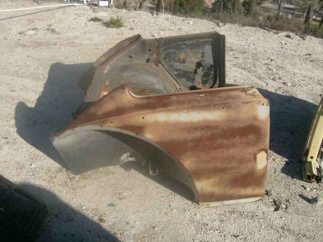

I think i've found a perfect donor section from California..........from a 55 too how perfect!! posted a wanted add on thesamba and no word of a lie the phone rings not 10 mins after posting and the caller id says california :D now I just gotta work out shipping.
I'll hopefully bring the father in laws MIG home in the next couple days, it will be a hell of a lot easier to weld this thin shit with than my TIG, I haven't quite got the hang of it yet (it's a scratch start, no pedal control :( )

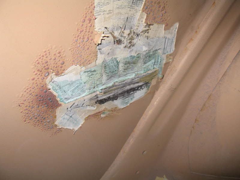

here's a couple shots of that nasty quarter that Bruce wanted, looks like they used all the scraps lying around the shop.
Project '54 Ragtop
« Reply #20 on: January 27, 2008, 03:38:19 PM »
Wow, they really were using scraps!
Initially, I thought they used one of the commonly available VW patch panels.  With the seam so high up, it appeared they made the most common mistake.  Most beginners will fit up the patch panel and cut the car at the top of the panel.  This is the worst way to do it.  You should strive to keep the most original steel and minimize the size of the patch.  You should cut away only enough metal until you get to good sound original steel.  Then trim the patch panel to match.

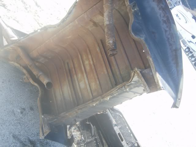

so I think we sealed the deal on the rear clip I found, using the seawings express cargo service from Blaine straight to Victoria the quoted me $68 for this big lump (thanks wayne for the link)
it looks really solid with only a little spot where the heater channel welds to the cross member that may need some attention, I hope to have it in my garage by the end of the week and start surgery :rockon:

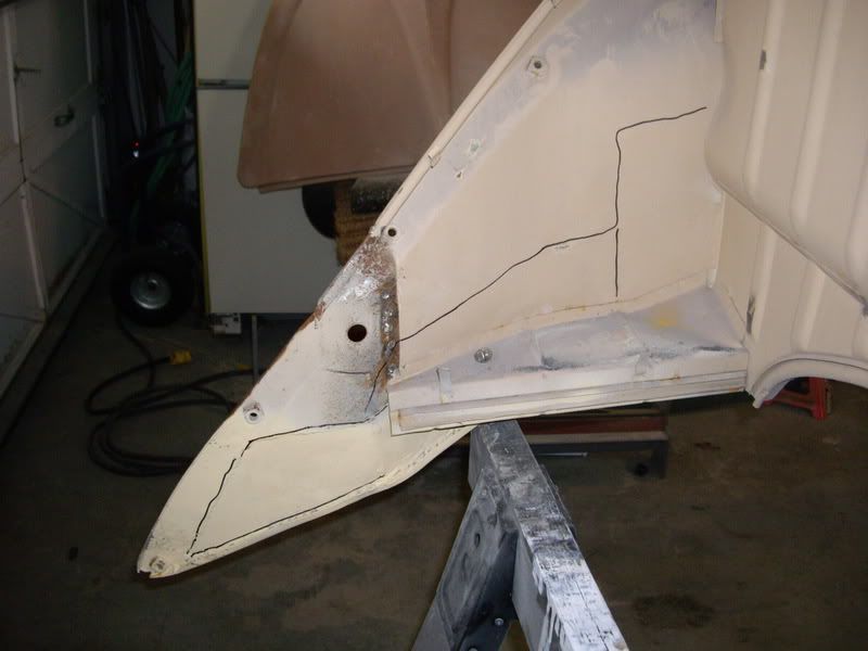

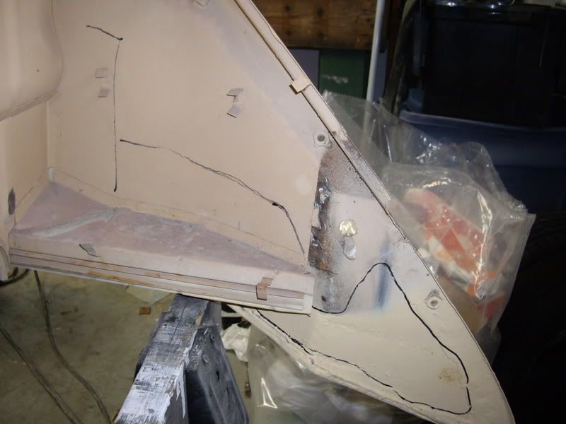

found some more scabbyness in the rear of the car. strips welded here and there, more lap welds, the majority of the fender mounting nuts must have been seized or broken of cause they are all messed with. all the black lines are seams :(
I think I will bit the bullet and order a pair of these from wolfe in sweden, got a quote of $295 shipped to my door. not too bad for the quality I have heard his stuff is.

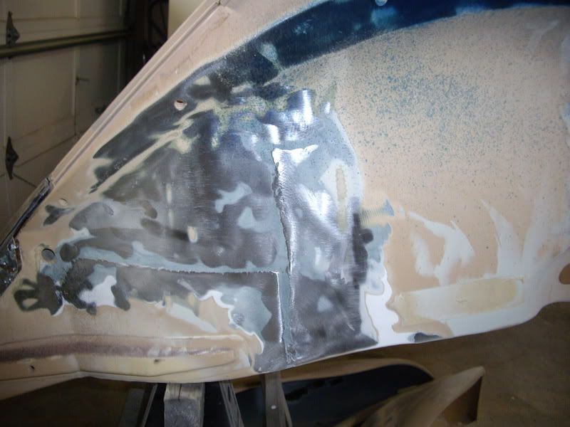

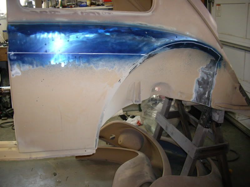

trying to descide the best place to graft the quarter panel/wheel wells in.............any experienced pro suggestions welcome.
Leaning towards cutting at the white line across the panel and follow the fender flange. then I don't know what would be better to use the pillar from the donor cause mine has some shady parts in the area under the rear door panel where it welds to the heater channel under the seat. OR slice it down the rear quarter lip where the door seal contacts it????
It was a tough call on the original non pea shooter H apron but after having both my last 2 cars have removeable rear aprons, I just can't go back to a solid one.

the rear apron isn't bad, here it is after a quick hammer and dolly, and a guide coat, still needs a little lovin. I made a stainless shrinking disk for my grinder and will be trying to get the panels as straight as possible without gross amounts of filler needed.
